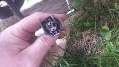

I have a 2012 that I am trying to figure out where this plug goes to. Its located in the drivers lower front facia area.
It is attached to a pigtail that branches off just before the horn assembly plug. The pigtail is about 12" long. Im rebuilding a wreck and some things were missing before I started.
The plug ia marked with
E3S8 14489 R
I appreciate is someone directs me to the paypal ford manuals but I did donate and when I link to the wiring diagrams it says that link is not supported.

I have heard it mentioned that there is an ambient temp sensor in the front facia area...maybe it goes to that?

Thats an idea. Ill try and look up that part

Thanks a lot, I googled the ambiant temp sensor and the pics show enough that I can identify the plug. Thanks.
