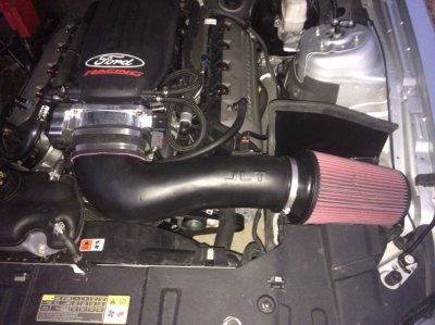

Do you have any pics of your JLT CAI on your Cobra jet intake? I'd be curious to see it, I havent been too impressed with the Ford Racing version.
ImageUploadedByTapatalk1392080192.301069.jpgImageUploadedByTapatalk1392080210.799114.jpgImageUploadedByTapatalk1392080226.566962.jpg
I hand modified the intake tube it flows more than a frpp CAI it is 5" at the throttle body and 4.5" at MAF
