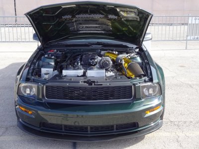

DF56F756-2AA7-47B4-8909-ED3836F85D9A.jpeg Re: the white flakes in your system, did you ever use Redline Water Wetter? I made that mistake, and I too had flakes in the degas tank. I have an 08 Bullitt with a Roush TVS, here in Vegas summer temps hit 110+, even in traffic at a stop light, my IAT rarely reaches more than 145. I have an Aafco heat exchanger with no fans. Mods consist of aftermarket radiator(C&R); 2010 GT500 heat extractor hood vent; and for the summer months I run distilled water and coolant at approximately 4-5 to 1 water to coolant ratio.
