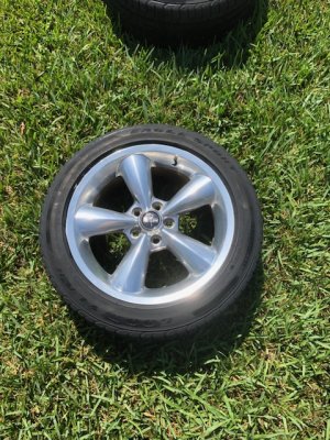

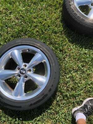

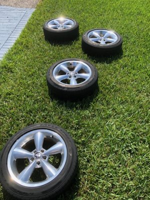

Do you like these?
Original 06' Mustang GT 18" chrome bullitts.
