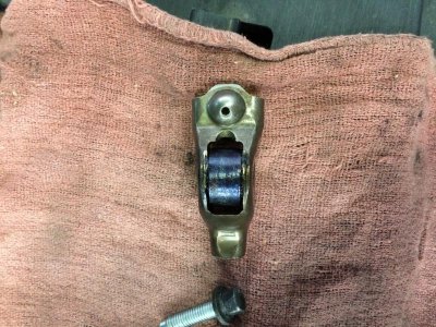

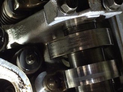

I had the random cylinder 5 misfire code that would show up during cold start. If I cleared the code and let the car warm up for 10 minutes, I could baby it for a little while and avoid the codes (cyl 5, random misfire, maybe others).
This was my issue.
Replaced the Livernois Stage 3 NA cams and the followers on cyl 5 and 6. No more codes.

Doesn't look like a cam issue.
