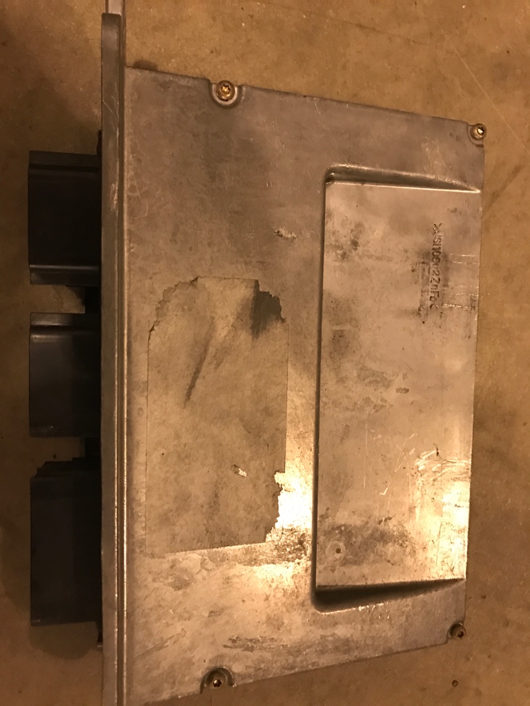

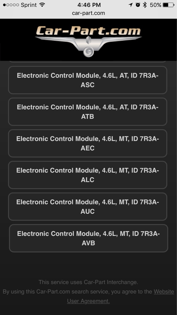

So I need to get a 2005 MT computer. A 2007 MT won't work? I only ask since 2005 was the first year and there seems to be more and more issues so I would like to put in one that is a bit newer. My computer doesn't have a part number on it. Just says show car.
Looking at car-part.com there are two options for 2005 with MT and 4 options for 2007 with MT.

Yeah, I have an email to him, but I think I found a better solution. There is a company called SIA Electronics that will rebuild it with lifetime warranty for $161. They said they see this issue with the ignition portion all of the time.
