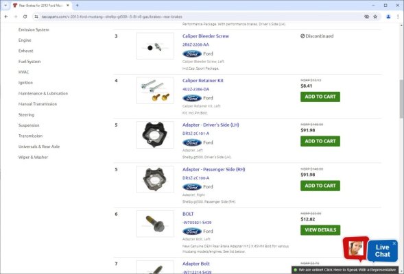

The 2013 gt500 rear brakes have a bigger caliper bracket. You'll need to pull the axles to get the old brackets off and new on. Your stock rear calipers will bolt to these and they will allow the use of the 13.78" rotors. The $91 parts below brake brackets.jpg

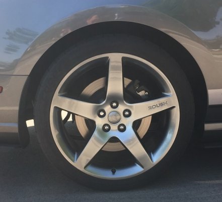

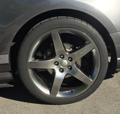

The GT500 Rotor swap is exactly what I did to my 2014 Roush Stage 2 (Roush Upgraded GT). This is an older list of the parts that I bought from a Ford Dealer after checking several vendors for pricing. These parts are all stock on the 2013/2014 GT500. Below is the list that I worked from to price check and eventually order my parts for the conversion. Also posted some photos of before and after the upgrade. I had a Ford Dealer's shop make the Swap. If you plan to do it yourself don't forget to get the proper rear differential fluid because you have to pull both axles to install the new brackets.
Here is a write-up on the conversion process with steps and photos.
Here are a couple of links to forum threads that helped me get this done.
Parts List
Before (Small Stock Rear Rotor)
After (Larger GT500 Rotor)
Before
After Matches up better with the 14" Front Brembo Rotor.
