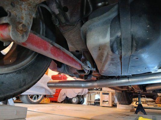

Recently purchased a 2007 GT 4.6 manual trans, previous owner stated the car had been lowered an 1" to a 1 1/2" no other modifications other than a CAI that did not require a tune and Borla S Type mufflers. I purchased the car to be a daily driver but wanted to pay tribute to the 1970 SCCA trans am series mustangs. The first thing to go was the Borla's and over the axle pipes, I added to 12" Cherry Bombs and approximately 21" of 2 1/2 " exhaust pipe exiting out in front of the rear tires on each side. I tucked the exhaust up as close as I could but could use that 1 to 1 1/2 inches of clearance. If I go back to original springs just on the rear do I need to be concerned with pinion angle? I have replaced the rear shocks and I told the wife people will stop asking who's got the mustang with all the stripes and decals, eventually. I did search for posts pertaining to my situation and if I missed it I apologize in advance.

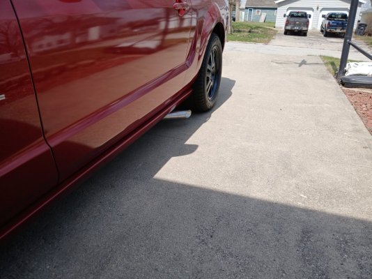

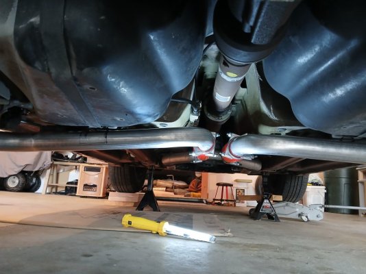

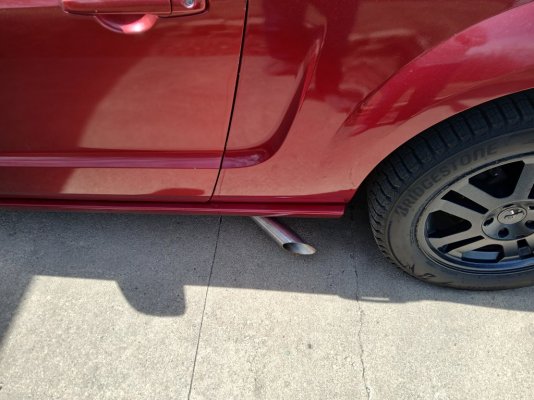

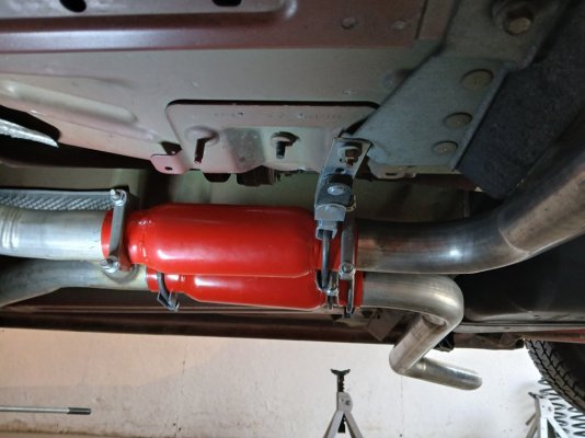

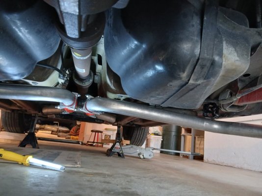

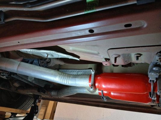

I hope the request was for pics of the exhaust and sorry it took me so long and sound clip to follow. After taking pinion angle measurements the consensus was correct and they are within 2 degrees of each other. I didn't take a step back pick of the car as it still needs to be decaled and looking for the needle in the haystack chrome bumper covers that sad to say have not been produced in 10 years. For the look I'm going for I think they would be a nice touch. Thanks again to all who replied.
