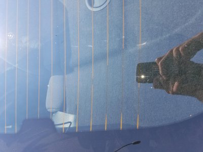

Hey guys, went to go get my car tinted with ceramic tint yesterday and the shop informed me lime 4 of my defroster lines are broken. Is there a fix for this other than replacing the glass and can I tint over it? TIA. Here's a crappy picture

There are kits you can buy to fix them but I dont know if it would work on such a large break? Does your rear defroster work in that spot?

Thanks for your reply. I was kind of reading a little something about the fix kits but I'm a little skeptical. I'm not sure if it's working or not as there has been a crazy heat wave the last 4 days here in cali

Its cheaper than replacing the rear glass lol, not much to lose. But I wouldnt worry too much about it. One of the grounds on mine in my old 00 gt was completely seperated from the grid and it still worked except for a little bit on the drivers side. I dont see those lines affecting much. I think the guy who was going to tint your car just didnt want to be blamed for it and have to get the glass retinted if you decided to get it fixed.

Thanks for much for your reply. I got a bitchin deal on installing subs and all around ceramic window tint do I guess I'll just grab one of those kits. Any recommendations on a brand?

I used one of the kits on my 2006 and it worked fine. Never had a problem with it. Also used it on my Mariner for multiple splits in the lines.

Ive never used one but I dont see them being much different. Im sure the ones you can find at advance are fine.

I used the frostfighters.com brand

I used a permatex kit bought from parts store to fix a tab that had come off.
Worked great for about a week and now it doesnt work at all again. Both tabs are still attached, no breaks in the lines, power at the tabs
