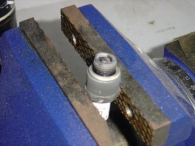

Speaking of spark plugs, you know not to ever use octane booster right?
If the plugs have an orangish tint to them, that means either you've used an octane boost with MMT or gotten premium fuel with it in it.
If that is the case, holler back and I think I have a way you can clean them and see if they work better.
Mike
Brake Cleaner?
What's your secret?
MikeVistaBlue06
Inventor: Asshole Points
Apr 5, 2007
2,169
31
Richardson TX
Brake Cleaner?
What's your secret?
No secret! :beerdrink: I think everyone thinks I am crazy as hell on this one! :wtf:
Take a propane torch and put the plug in a vise (in a well ventilated area) and use the torch to heat the plug up until it glows orange, and that should clean it up!
See before/after pictures at bottom.
Note: LET THE DAMN THING COOL GOOD BEFORE REMOVING IT!!!!! :onfire:
Hope this helps.
Mike
