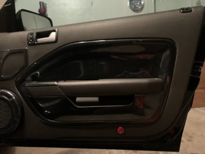

My predator inserts are being shipped out Thursday. Question. What’s the best method to remove excess adhesive and little bits of the door panel insert foam that was left over after pulling the foam off. Light sanding?
Light sanding, goo-gone, followed by rubbing alcohol.

Not quite what I thought they’d look like, but not bad, much better then before. Door still needs some touch up, new pieces make the rest of the vinyl Look even more faded!
