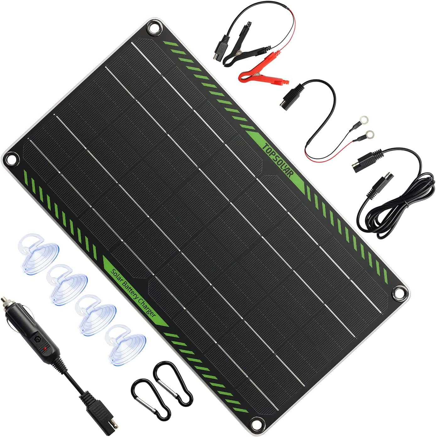

Or you could use a solar charger. They seem to get good reviews on Amazon. This one is 10 watts and $20.
Is that a charger or a tender? If it's a charger it's going to put out way too many amps to keep on there non-stop. As small as it is, I'm doubting it would work very well either way.
Best thing is to get a long outdoor extension cord and run it out of the garage. If you have external plugs on your house and that's the way you are wanting to go then I suggest a plastic cover box that seals the entire plug and the cord runs out of the bottom of it. Then run that cord out to the car. Run the extension cord up from underneath into the engine bay and plug the tender in under there too. Just make sure it isn't touching the hood when you close it and you should be all set. I left my Corvette on a tender all winter long and it never hurt a thing. I always had my 6.0 Powerstroke parked outside on a tender as well as the block heater all through the winter months when I was stationed in cold weather places.
10 watts would not make much of a charger. It is a solar tender with circuitry that will keep a battery charged without overcharging it. You just plug it into your "port" inside the car and stick to the windshield with the suction cups. I really don't see the need to use a cord for just a battery. Block heaters are another story.
