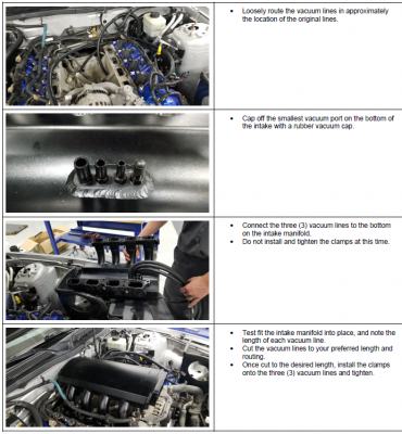

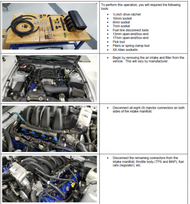

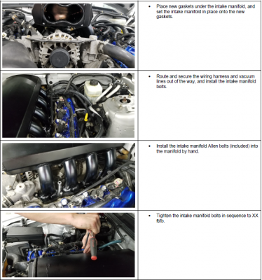

I wanted to share my input on the sniper gen2 manifold install on my 2005 mustang gt 3v. factory hood no scoop. Feedback is always welcome. If you tell a 5 guys to replace a part, youll have 5 different methods. This is just what worked for me. here you go.
