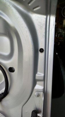

Had the same problem with my Roush spoiler and they created a "kit" to solve the problem.
Drill two access holes inside decklid support framing, drill holes from the inside of the deck lid into the spoiler, install screws from said kit, cap access hole, done. Use care to avoid stripping the spoiler.
Guessing you could find the parts easy enough at a hardware store.
