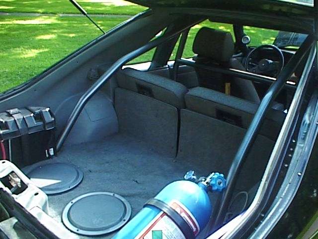

Thank you for the kind words! I came up with the idea as I had used the spare tire hole on my 89 LX Hatchback. When I removed the sub box and dropped them in the tire hole the system came alive. Having the subs fire directly in to the window and shoot the sound/thump directly at you made it sound so much cleaner. Wanted to do the same with this car and wanted something original for car shows. Take your time and do it right... don't forget the dynomat (or other brand) when you do the rear deck.
This is where the idea came from:
