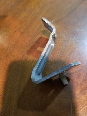

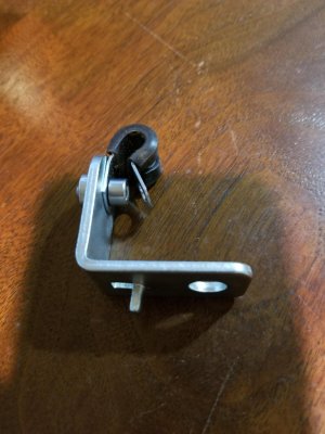

I have the Steeda s/s brake line kit. Rear wheels installed effortlessly. Replacement bracket was an exact match for the OEM part. Front wheels, eh. Stock bracket was brazed to the AN female fitting. Heavy steel, left and right mirror image. The brackets Steeda sent are drilled for the 10mm bolt and with an index tab, just like the stock ones. Instead of angled/twisted steel with a 5/8"/16mm hole, they are simple "L" braces with a hole threaded for an allen bolt and a pinch clamp. The clamp is sized for the brake hard line. When installed, it's an inch or two short of the hard line. Since the Steeda brackets are identical and have index tabs, I can't have installed them backwards, upside down, or swapped left side to right. I cut the bracket from the OEM line, but haven't drilled it for the AN fitting yet. Attached are two pix: one of the Steeda bracket and clamp, one of the stock bracket cut from the OEM line. Can't figure out how the Steeda brackets work (if they do), and for the first time ever, Steeda has not been helpful. Please tell me if I need to fabricate my own brackets, or I am too freaking stupid to figure out how the Steeda brackets install. Thanks!modified OEM bracket.jpg Steeda bracket and clamp.jpg

So the new bracket is supposed to replace the stock bracket holding the hard line? Or is it supposed to hold the braided line after the hardline connection? I only ask because I can't remember what the stock set up looked like.

I believe it's supposed to replace the stock bracket, because the OEM one is brazed to the line fitting. The clamp for the Steeda bracket is sized for the hard line. When the new bracket is bolted to the frame, it's nearly two inches away from the hard line, and the wrong angle/ orientation. I don't want to bend the hard line (and I doubt that's what Steeda wanted me to do). The picture I posted of the ugly bracket is the one I cut from the stock line and have bent to meet the fitting on the new line. I still need to drill a 16mm hole in it.

It replaces the stock. While I installed Wilwood brakes and lines, I had a similar situation. Its up to the installer to make it work. This is a quote from Wilwood`s instructions.
"In absence of specific instructions for brake line routing, the installer must use his best professional judgement on correct routing...." It goes on and on but you get the idea.

Bending brake lines to fit is fine as long as yo don't put a kink in it. I had to move mine in a bit in order to mount my solenoid. I don't think it was too far but I remember doing a little bending. I also think my actual line is zip tied to my wheel sensor wire.
If you wanna use the steeda bracket why not just drill a new mounting hole higher up or wherever it needs to go. :shrug:

"If you wanna use the steeda bracket why not just drill a new mounting hole higher up or wherever it needs to go."
DOH! Maybe it's Steeda option #3 from my earlier post (pass this around so everybody has a good laugh).

Just to wrap this up: There was nowhere in the wheel well to put the Steeda bracket that came close to the hard line/braided line connection. I cut both OEM brackets off the stock lines, clamped them in a vise, and beat the *$%# out of them until I got them to line up with the new lines. Everything is fine now, but my view of Steeda support has dimmed from outstanding to merely excellent. Thanks again for all the suggestions.
