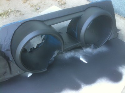

i just did mine this past week and i loved how it turned out. i did about 6 coats on the gauge pod and about 4 coats on the vents.
