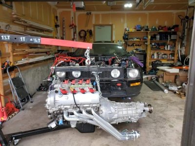

Wow I have never R&R an engine and tranny combo at the same time with the hood on!
You got pics or video of that install?

I don't have a video of that install with the hood on... Because I was wrestling an engine into place... [emoji23]. But I did do it with heads on and Kooks Long tube headers installed. I had a TR6060 transmission attached as well. I did not remove the steering linkage when I did it. I will say that I do have a tubular K-member so that might have helped.
With the engine on the hoist, I came at the car from the driver side (legs of the hoist by the wheel well.)
