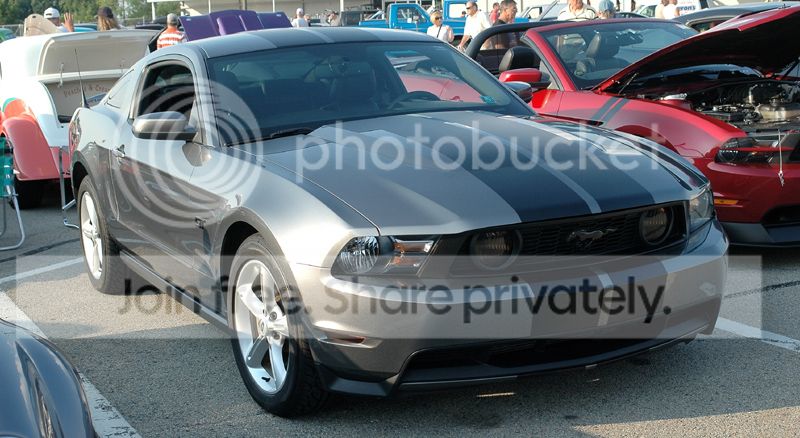

Edit to add: I do have a sct tuner to recalibrate speedometer
Edit to add pic
claudermilk
Jul 12, 2012
1,840
SoCal
Looks stock height to me. Got that 4x4 look.
I'd go with option 2 if it were me.
