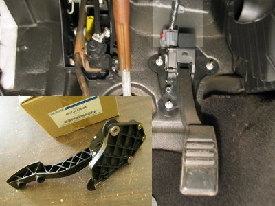

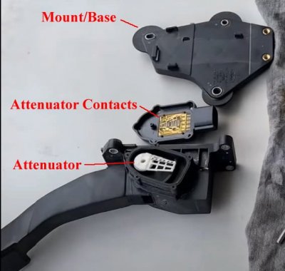

OK, I was able to get a pic of my pedal and a pic of the cheap plastic it's made of (first pic). I could only find one YouTube vid of the pedal disassembled (second pic) Third pic is of the attenuator inside the pedal. There might be a spring behind it but I can't find any pics or references to a pedal spring. Fourth pic is a screen grab of the Shop Service manual description of the Throttle body mentioning springs in the TB.
As mentioned in a post above this, there is no shaft or link or any external connection except an electrical pigtail.
I've pushed my pedal down with engine/key off and there is definitely a spring somewhere; it does feel like it's in the pedal. If it's a simple coil around the pivot I can probably make a spring for it.
The video poster pointed out that the attenuator contacts need to be cleaned off occasionally, he suggested a pencil eraser. My printer cartridge supplier suggests this also.
I'm tempted to get a used pedal off Ebay and detail strip it just to find out if it does indeed have its own return spring...

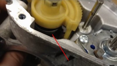

Found a video on the ETB, took a couple screen grabs of the 'flat' return spring and the 'plunger' or maybe limit/idle adjuster. Doesn't show how to get the split gear off/on or how to adjust it afterwonds.

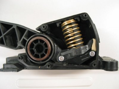

While I'm waiting for a new TB sensor (mine has the old round sensor; new square one coming), here's a pic of the pedal spring(s). There's actually two, one inside the other, and they're really strong.
