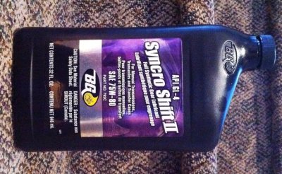

Is this what you guys are talking about?
I think that my be an older package or older product. Here's what I used:
Some day I'll figure out how to get the full-sized image to show up when I attach one. Just click on the thumbnail to see it full-sized.

/\ The black and purple bottle is the correct stuff.
I noticed with the original fluid that was put in my new trans even when warm I would still have trouble shifting into 5th and then to 1st when coming to a stop. With the BG fluid that is not a problem anymore, even when the trans is still cold. It was 25 degrees this morning and it was smooth as butter.
