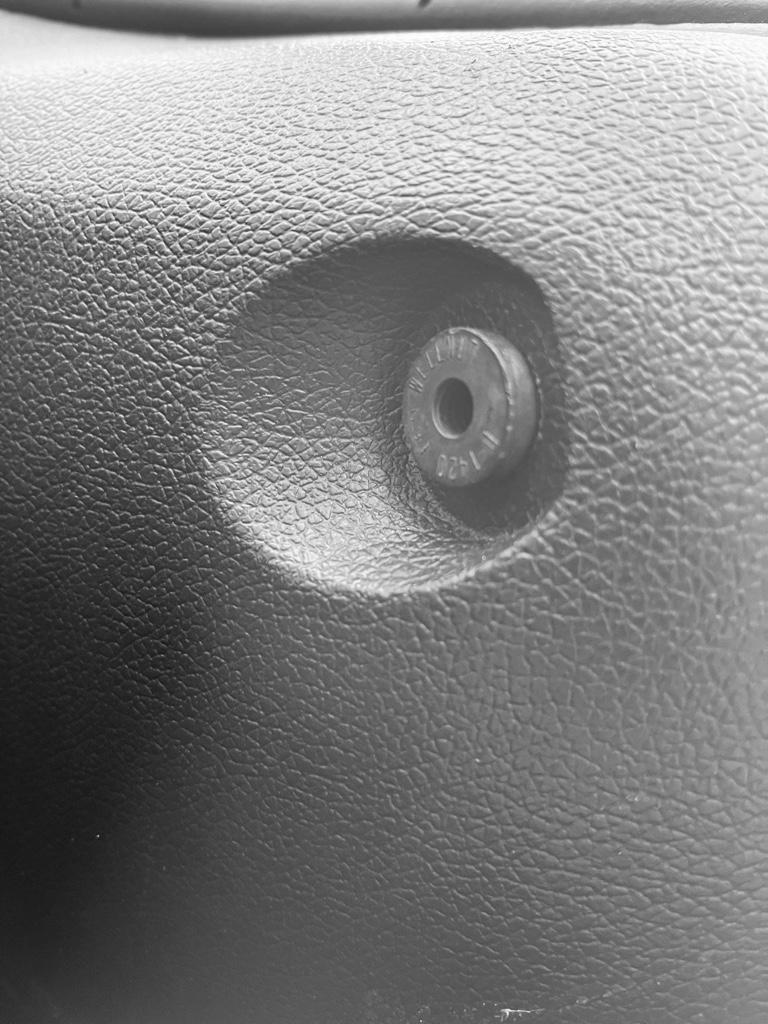

Fed up with the little plastic nuts that are supposed to hold the trunk lining in place. They are directly opposite the tail lights. By chance I discovered these Well Nuts make a perfect replacement and as they have metal threads, they will not strip out like the stupid plastic ones.
Search D1420 Well Nut, there are multiple suppliers.

One of my plastic fasteners broke so I invented a different solution. A long nut with an allen bolt and a plastic washer. I used Loctite to fix it.
This is almost exactly what I did. But instead I used a metal washer and a philips bolt/screw. Never have an issue with it again. I also colored everything black for it to blend in with the interior.
OH Thank God for you this has been a pain in my ass for years now I've bought so many of them damn plastic trunk trim retainers and they are worthless......Please tell me where to buy these asap !

I got the ones I have at Lowes, but there are many sources, on and off line.

Can anyone post a for sale link with the correct application? When I do a search for "D1420 Well Nuts" I get all sorts of sizes. Thanks
1420 is the size designation.
