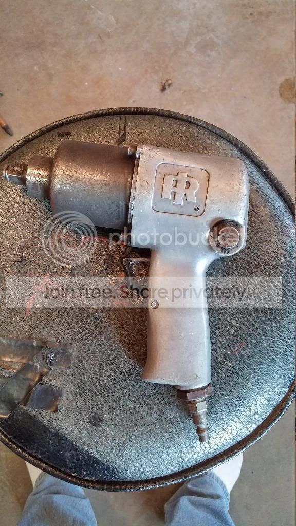

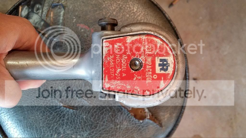

If you plan to continue wrenching it might be time to invest in a compressor, they're incredibly useful and the tools they give you access to can be invaluable.
You absolutely get what you pay for in air tools though so if buying new you won't get off super cheap. If you know where to look and what to look for there are deals out there.
I bought my Ingersoll IR-231 used off the Snap-On truck after a professional mechanic traded it in so it had seen HEAVY use before I got it. I've owned it for almost 30 years now and the thing still rocks.
Besides the impact you have access to air hammers (amazing tool), ratchets, sanders, drills etc.
Couldn't imagine not owning air tools.
