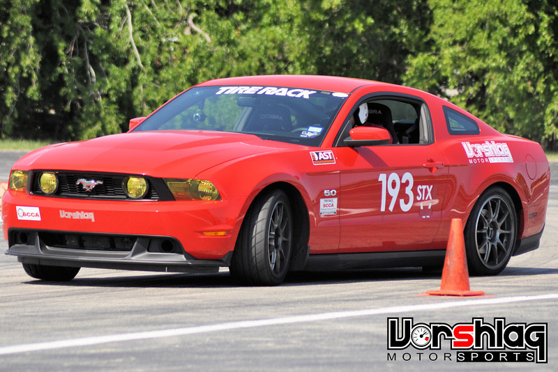

One thing that is sorely lacking in that list is adjustable camber plates, and I think the OP even mentioned that. This is normally the FIRST upgrade done to any S197 or S550 Mustang that will see track or even autocross use. The tire wear savings up front can often pay for the camber plates in "ones of days" of track time.
The next obvious thing that might bite the OP for track days are the 13.2" brakes. I just talked about this elsewhere in this forum earlier today - go read about the "fun" I had when trying to push the 13.2" brakes on my 2013 GT on track here. The 14" Brembo upgrade is pretty much a no-brainer.
What else... well, there are a lot of "doo-dads" on the OPs suspension parts list, but hey, its a Mustang - people like to buy a lot of shiny doo-dads, even if they don't do much. ;)
The shocks/springs could be a lot better, but the OP's bits better than some setups I've seen. The big glaring limitation is the 18x9" wheels... go to a 10" wide wheel at the least (if your class allows) and an 11" wide wheel is even better. Running a wider tire is the biggest improvement in autocross or track times than anything else you can do. We spent two seasons in the wrong class, where we were limited to a 9" wide wheel and 265mm tire. It was two years of pain.
Even with a "worse pax factor" by upclassing, going to an 18x10" wheel and 275mm tire instantly made this car a LOT faster relative to the rest of the 160+ car SCCA field. Going to an 11" wide wheel and 315mm tire made this car a Winner and Top Pax finisher many times - again, with a "worse PAX" and harder classing.
You can never have too much tire under a Mustang...
