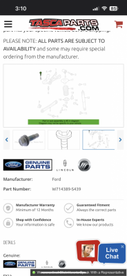

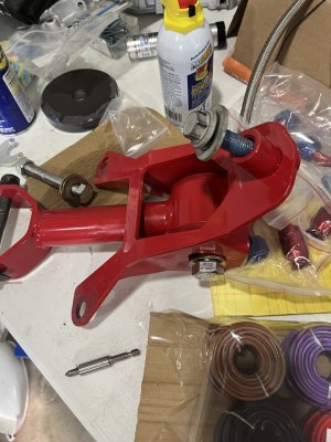

I have a 2006 but was told by BMR that the upper control arm bracket for the 11-14’s would work on my car. Said I might have to trim the gas tank lip but they’re interchangeable!?! Well I go to bolt it up and the bolt under the seat is way to small. Called BMR and they said I should be able to use all factory bolts…well, I can’t. You can see in the pic it’s way to small. Anyone know if the bolts are different? Will ordering this bolt from Tasca fix my problem?

Yes the 2011 bolt is bigger. Yes order one from Tasca. Yes the 2011 upper bracket will fit. Its unlikely that you will need to bend the tank flange. Loosening the gas tank straps will make the job easier. I've had this on my car for years.

you shouldnt use the 11-14 mount with the 05-09 arm tho. Ford made the arm longer for the later cars and moved the mounting point in the mount, your likely going to have a very negative pinion angle if you use the early arm in the later mount. you can use 11-14 mount and arm in the 05-09 cars tho. good luck.

Well crap…1st I’ve heard of this but it makes sense I guess! Had the part for over a year, never installed, maybe BMR will swap me out.

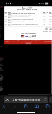

They did!! I called them and he emailed me another receipt showing where they swapped the control arm for 11-14….+1 for BMR!!! Guy was cool said he understood the confusion
