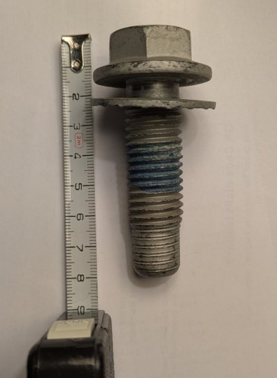

The M18 (?) bolt under the seat is one of my technical hurdles, don't want to buy a one-trick-pony torque wrench for it. Already bought a TP50 for the tank straps and no idea how to torque the bolts on curb high without a lift. To get the rubber bushing out of the diff housing is no fun too.
FYI, the TUV don't care about these control arms as long as they are black and look tubular ;) Nobody ever ask me about my J&M LCAs. Color always screems "look at me" :)

Yea....No, the 11+ spec is 475 Nm.....yes really. The facelift UCA is longer and the whole car is much more stable during heavy brakeing. So you need a long 3/4 inch torque wrench for this job.

All I have seen that the 11+ arm is much longer, bushing bigger and the lever for the bracket too, so the force on the bolt much bigger. I guess that is the reason for the new M18 475 Nm bolt (and glue on it).
