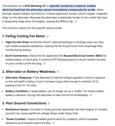

Sounds like it's time to start replacing some worn-out parts. (Alternator?, Battery?, Cooling Fan assembly?) And as mentioned: A good ground!!!!
Note: When my car is idling, the voltage to the battery is reading 14.4V. You can put a VOM on it to check that reading.
