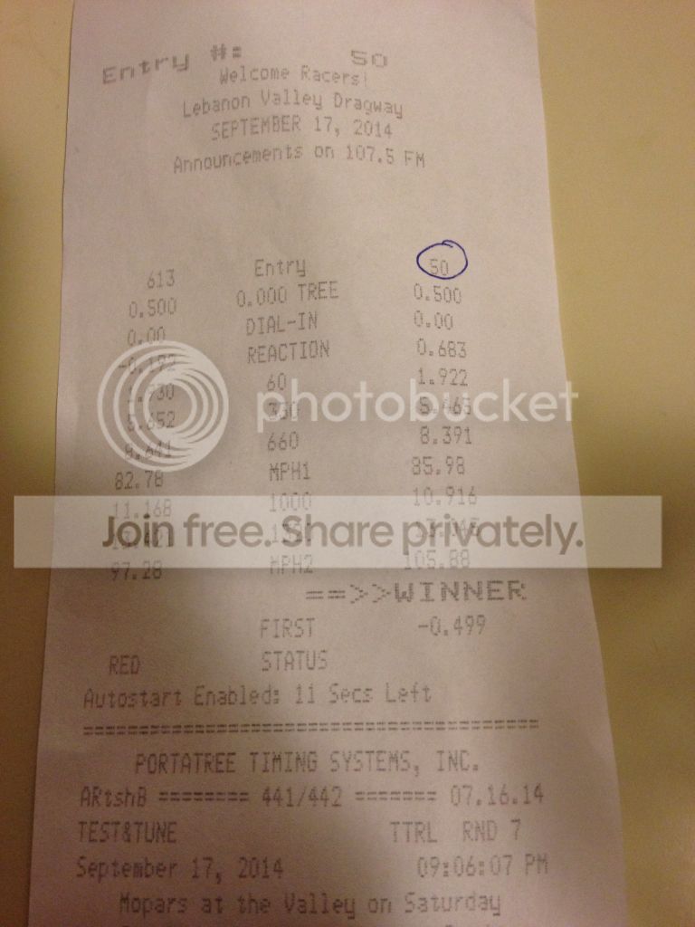

The details of the car are
Completely stock suspension except for sportline springs.
Jlt CAI, CMDP, O/R H-pipe, GT500 mufflers and a tune.
Tires are tired 20" 285/30/20 nitto 555 radials
Tr3650 with stock 3.55 gears.
The runs where consistent. I have to slip the clutch a lot on the launch or it spins bad. I want to get some good tires and I have 4.10's in the garage waiting to go in. I will need suspension. After that I want to do something to raise the mph a bit. The goal is to get the car to hook like a mofo and mph around 110.
Here is the best run. 60'- 1.922 et- 13.045 mph- 105.88

Nice runs!
As far as hitting 110mph, slap those 4.10s in, get a lightweight drag wheel setup with a 26" bias ply slick out back, side step the clutch at 5-6k and bang those gears. I'll bet you will be around a mid 12 and be close to your 110mph mark. :beer:

Not bad, some tires will help you out!
What are you shifting at? I've only trapped 110 three times with bolt on's in good DA, usually 106-108.

Those are some good times for your setup. Good skills man!

6500
I want to get a shift light. I need to get more consistent with where I shift. I am guessing that is what happened to my 1/8 on the first run. It's not inline with my other 3

6500 is a good range, I used to wring out 1st and 2nd to 6800 but that was with 4.10's you probably won't benefit from shifting any higher, not bad on the 60's get some ET streets to hoosier QTP's and dump that clutch from 5 grand or more.

A proper drag radial heated correctly should get your 60' times down to 1.75 (or better). That alone should drop your ET's from 13.0's to 12.7's or 12.8's and make the car more consistent and easier to launch. The 4.10's will likely net you another tenth or two. Neither will improve your trap speed, though.
Trap speed improvements will have to come from breathing improvements (i.e. cams, heads, long tube headers, forced induction, etc.) and/or by a lot weight reduction.
