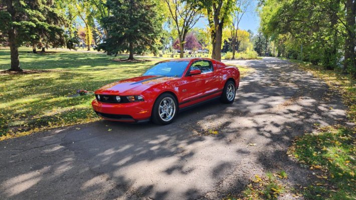

Please post some pics of your car.

Nice clean car!
Thanks! I was pretty smitten when I saw it and bought it last year with only 32,000 km on it. I've since had a custom dyno tune (night and day from the Roush provided tune), and somewhat sorted out the factory suspension. Interior smelled like new. You don't want to know what I paid for this, (far, far too much!) but hey, it makes me happy.
