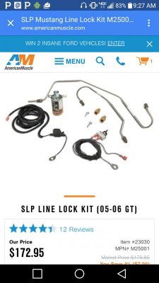

This kit?
23036
if so, yes, it's a toggle, I'd suggest to the right of the steering wheel and left of the center console.

This kit?
23036
Thanks for your help Dave, looks like the same I got. Will mount it where you Told me

funny, I got the image I used off of AM as well, yet it's a different picture.
