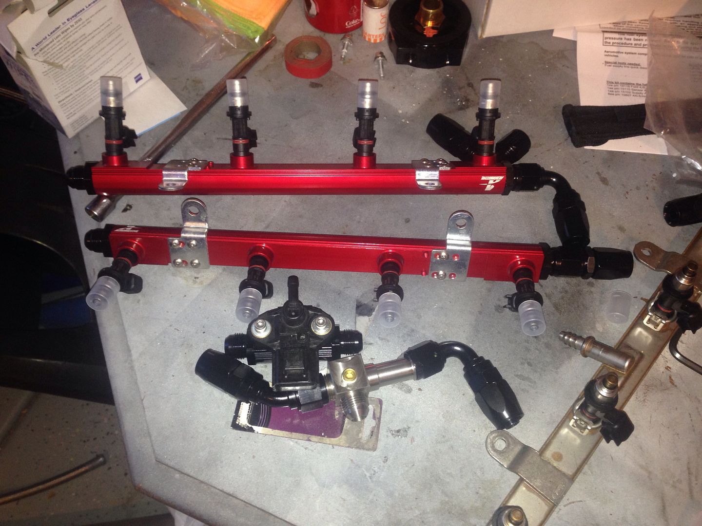

What fuel rails are you running? I like the look of that set up!
07 Boss
Jan 25, 2009
3,863
991
Sin City

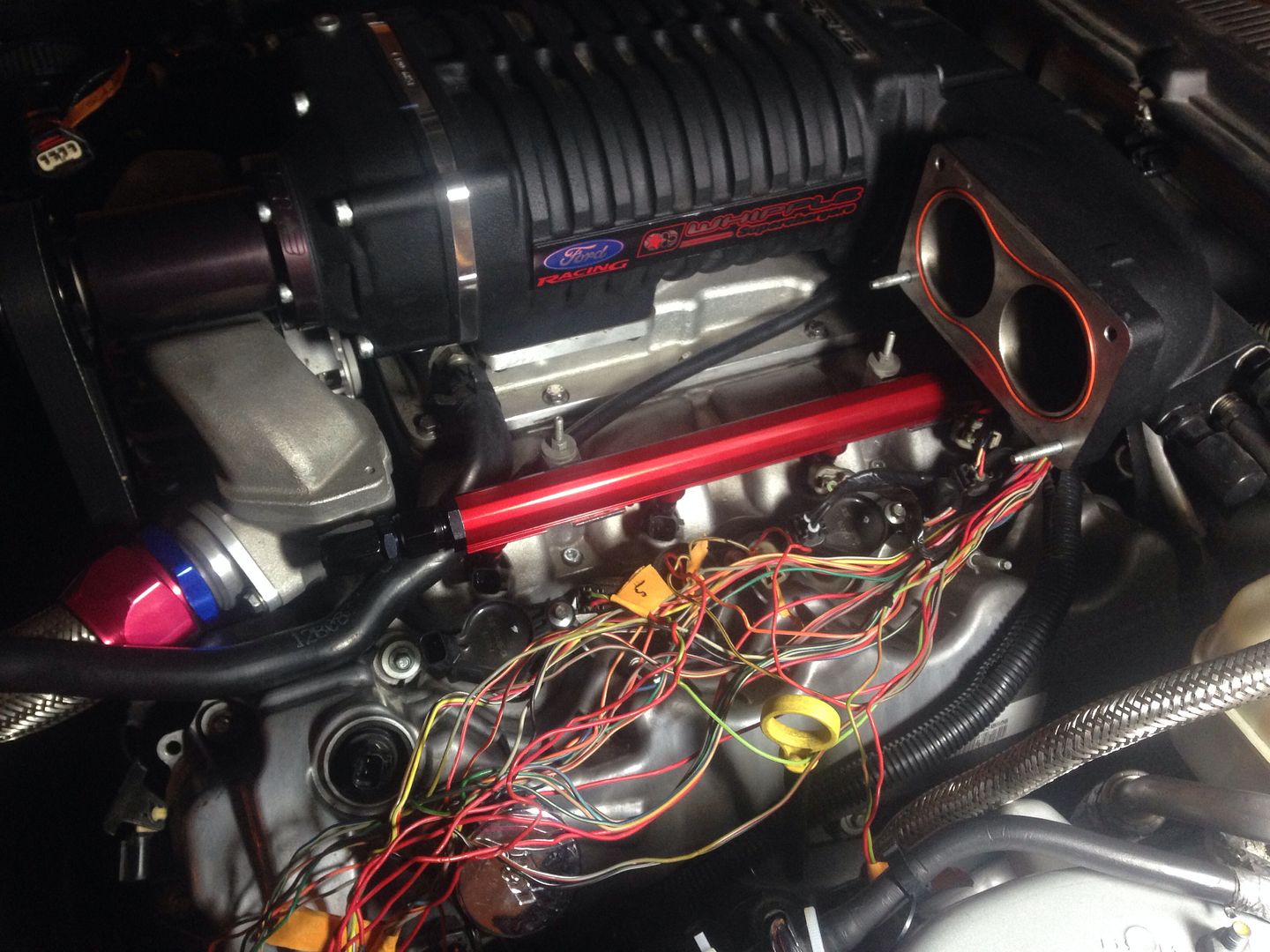

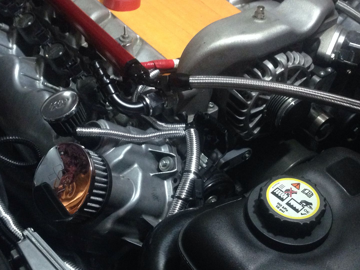

Aeromotive rails. they are a little pricey with their fittings but top quality. I plumbed it a little different with an individual line running to either side with no crossover.

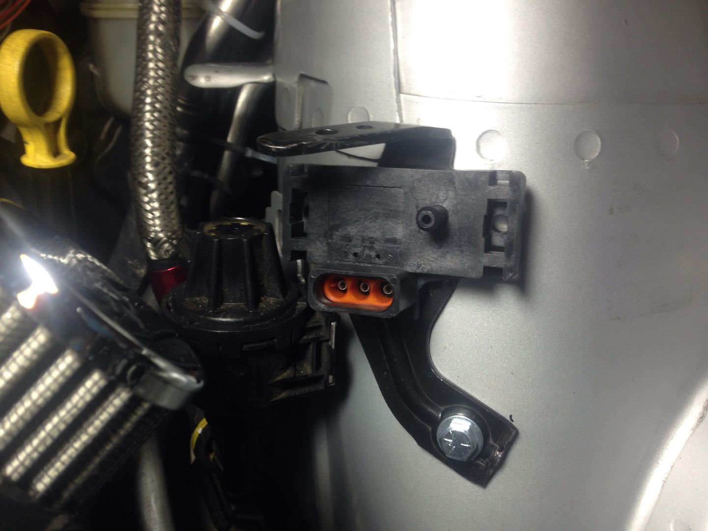

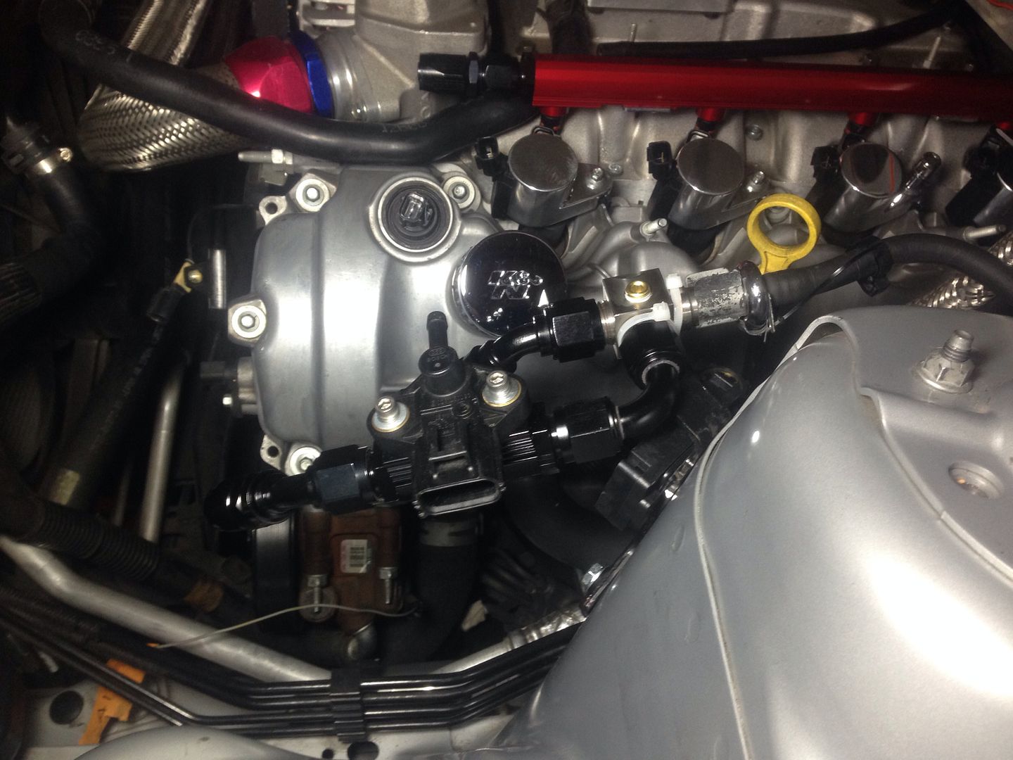

I ran the main fuel line up by the driver's side strut tower and it splits from there. Moved the FRPS over to there and have my pressure gauge sensor there also with the boost gauge sensor split into the vacuum line there. It made wiring the 3 gauges (oil pressure sensor on that side of the engine too) easier and neater.
Lol, I cut my old alternator bracket in half and used it to mount the hardware to the strut tower.
I have a place down the street called House of Hose, great name for Vegas. Anyways, They put all of my lines together for me for pretty cheap as I hate effin with steel braided lines. I always end up bleeding.
Had to get a little creative with the passenger side as the heater hose was in the way. Couple of different fittings and I got her plumbed. Below is a pic of what I did there.
