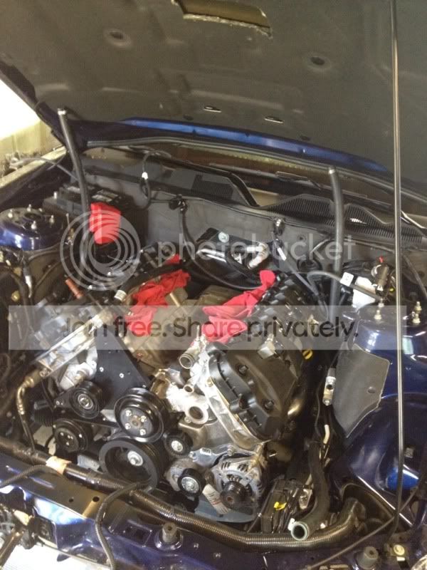

Glad to hear your back together and running,good luck.now I get to start my rebuild I'm also going a Boss short block.

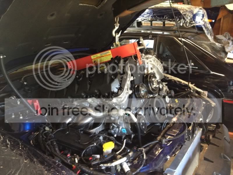

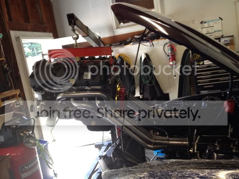

Got a new slave cylinder yesterday and installed it along with the JPC clutch line kit.
Also borrowed a load leveler from a buddy, and had a friend help me drop it in this time.
Still had a little bit of trouble getting it to line up, but that was mostly because the motor mounts hit the studs and its hard to keep the trans in place. I put the cross member bolts back in the trans and did a little shoving and it went in about 150 times easier than the first time.
Got all the trans bolts tight, trans cross member, motor mounts (not easy with new headers) and all I need is a little clip and the clutch line will be all installed too.
Any other tips on this part? I have a leveler, new slave cyl, and I spent 3 hours unsuccessfully trying to mate these two parts.
Putting the trans crossmember bolts back in helped me the most because when I pushed on the motor it actually went back onto the trans instead of just moving the trans back. It's just a bitch. Did you turn the clutch discs with the alignment tool to line up the leading edge of the splines? Also you can put a socket on the crank bolt and turn the motor over (easier yet with no plugs in the motor) to help line up the clutch and trans.

Just spent the better part of an hour reading this thread.
Great write-up; glad you had success with your build.
