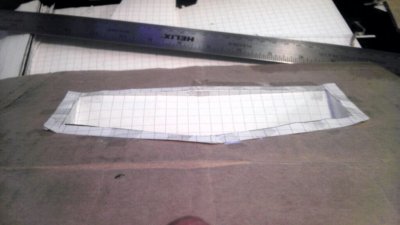

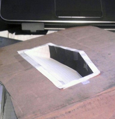

I made a small model out of paper too to test some of the dimensions

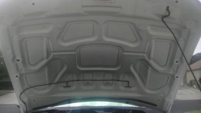

I was thinking about louvers since the hood is aluminum it may be easy to punch some in.
Are you going to remove the insulation under the hood? Id like to see how the webbing is laid out but I dont feel like removing mine.

I'll probably just cut through the hood, bracing ribs, and blanket in one shot with my jigsaw. You can get a decent look by just tugging on the blanket and peering under it.

Yanked the blanket to have a look at the bracing and it's good news. Man too bad those front pockets are too far forward to do much, cause they'd look cool!
I think that even if I go to my full intended width, the bracing removed won't compromise strength.
