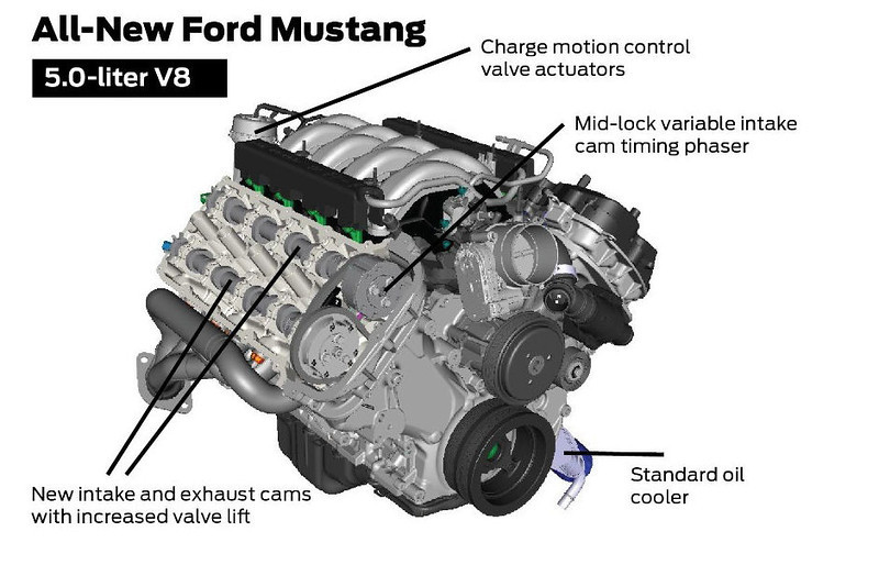

There looks to be some changes to the 5.0 engine - with the best parts of the Coyote and Boss302 motors kept - and luckily they've kept the Coyote intake manifold, which from our testing makes more power than the admittedly better looking Boss302 manifold at all RPM levels below 6500. The dreaded Boss302 engine oil "heater" (aka: "oil cooler") seems to be on this engine, however, so we will be working on a fix for that early on. This system is somewhat crude and uses radiator coolant through a sandwich plate above the oil filter to "cool" the oil. It works terribly in the 5.0 track pack and Boss302 engines, but maybe they got it right on the 2015?
New high flow ports sounds promising, as does the large camshaft profiles, so long as they didn't kill the lower RPM power that the Coyote 5.0 is so good at. Forged crankshaft and sintered rods are a carryover from what I can see but larger valves and stiffer valve springs sound like an upgrade. Looks like the same tubular steel shorty header carries over as well.
Nobody has a solid power number for the "new" 5.0 other than "it will make more than 420hp/390tq", which is what the 2013-14 model GT motors made. Like the C7 Corvette I suspect that the Ford drivetrain engineers will be tweaking the final engine and tuning package until weeks before production and we won't know the final power number until just before ordering starts. I suspect it will be rated around 440-450 hp, but don't quote me because that's just a guess based on what Ford has done in the past when introducing a new model but with a mostly carry over engine. This car will have the same MT-82 Getrag 6-speed, as our Tremec rep told us they didn't get the bid for the GT. But we're hopeful that there will be a Tremec Magnum XL direct shift transmission in the "Voodoo" powered version in the future...
