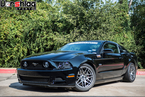

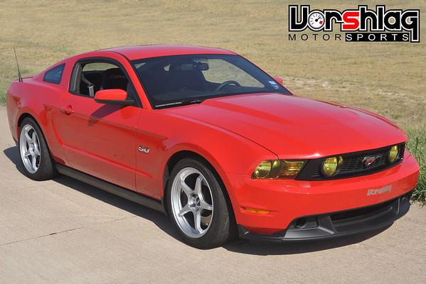

Well the old car could take 10" wheels on all 4 corners, and 11" wide wheels if you watched every millimeter (black car above is on 18x11 and 315/35/18). And even a 12" wide rear with some swaybar changes and a Watt Link (see below).
Technically we fit a 345/35/18 rear on the 2011 GT's fenders, but the axle moved too much under lateral loads
I'm hoping the S550's wider rear fenders will accommodate a 13" wide rear wheel and 12" wide fronts under stock fenders. And without a solid axle floating around back there we might have enough luck to get the 345's to fit this time without rubbing. But if it won't fit, we will make sure that it does...
