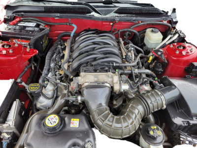

what motor do i have>?
whitmanink
Dec 28, 2020
609
267
denver pa
hey guys hope all is well,,
today i got my engine , off a AA auto on ebay ,
when i got the motor , the add said 05 06 07 08,,
i dont know what year it is tho,, and if i have the dreaded spark plugs,,?
i can see the intake is 2 piece cmcv ,
the heads have an 05 stamped on them at the exhaust port,
the coolant stuff is the same as my 09 tho,, (from one head to the other by alternator)
other than that i dont really have much to go on,, i did open each valve cover to look inside,, all cams look good,, zero scuffs or scoring on the lobes,, just oil varnish
with that said, the cam caps have numbers for identifying which goes where,, my 09 do not , they were blank

Are the plugs still in the new motor? I believe the newer style heads take a different spark plug socket than the ones with the dreaded plugs.

Both the older and the newer plugs require a 9/16" socket so that's no help in distinguishing between the two.
The difference is in the thread diameter (16mm older & 12mm newer).
The driver's side valve cover should have a barcode label stuck on it with the middle six digits showing the build date of the engine.

Are the coil boots different? Black for early years and brown for the later?

Two important differences between the early 4.6 and the later 4.6. Those are the coolant crossover and then the spark plugs. As stated above, black boot or brown boot on the spark plug leads? A pic of the coolant crossover on the front of the engine will also help.
If you got a long block from Ford in 2014 then there is about a 99% chance it is the newer style. I doubt they would sell you the old design 15 years after it went out of production.

I looks like the coolant system I had on my 2006. I can see the hoses going in/out both sides. I’m still learning so don’t take my word but I just replaced my crossover and it looked like that setup

It's definitely an 05-06 'cause it has the earlier style coolant crossover with two hoses coming from the top, so that should answer your query. Mine looks exactly the same but not for much longer 'cause I have all the parts needed to convert it to an 07-10 style cooling system.
As I mentioned earlier, read the middle six digits on the driver's side valve cover barcode sticker 'cause these show the build date of the engine.

the engine came with no coils , and also they spray painted the valve cover,
if it is the old heads, i can use my 2009 crossover tube to make it newer ?
as for the spark plugs, if its different mm than im stuck with the crappy plugs,,?
im afraid to take a plug out just incase

soo my coolant crossover is the old style,
i have the newer one from my 09,
can i just switch them to use the hoses i got , or is there more i need , ? thanks again guys

You'll need the newer crossover with its thermostat housing and thermostat, upper/lower radiator hoses (two instead of six), a gasket set for the crossover, and a gasket for the t'stat housing. You'll also need to lightly modify (easy) your existing alternator mounting bracket to make it fit. Don't even bother trying to look for a newer style alternator mounting bracket 'cause they've been discontinued.
When I eventually get around to converting mine, I'll do a comprehensive write up with lots of photos.
