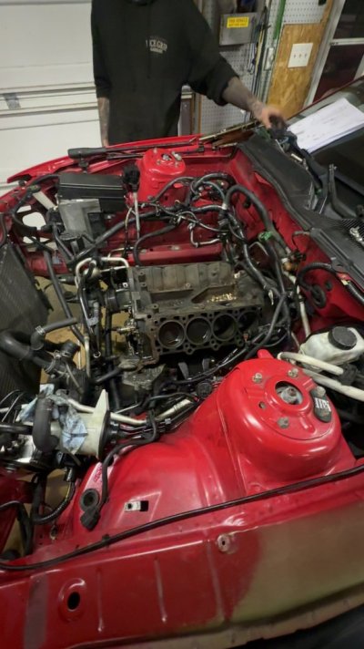

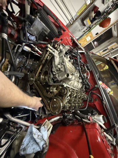

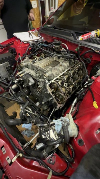

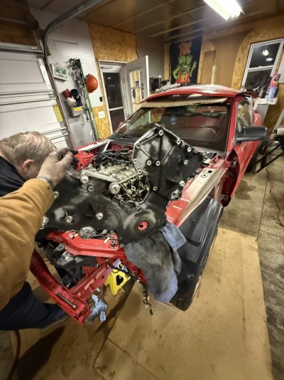

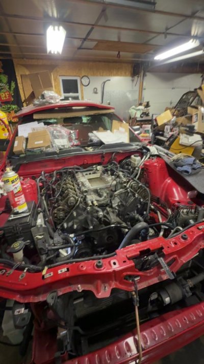

Thank you again though! I will most definitely get a video asap and post it! Also will be attaching any pictures of the motor apart and such if anyone spots an issue I missed maybe
