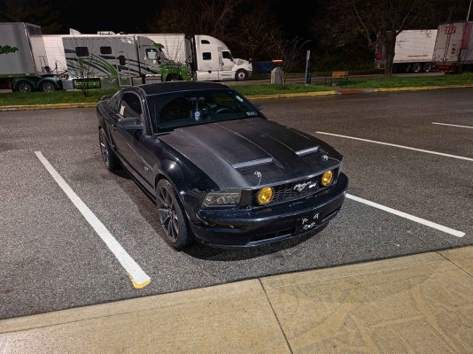

155k , its had all the timing components replaced, vct solenoids and seals replaced, the oil pump i am not sure about but i would imagine it also has been replaced when they did the timing job [before i owned it] that i am not certain about but i definitely cannot do that at my apt complex i would have to pay someone to do that job. I have all the tools i would need as i did the cam job , really dreading messing with the cams again but if it has to be done it has to be done. Typically, i only buy my parts on CJ Pony or LMR I've bought small things from american muscle but i don't tend to shop there. I would share more pictures of my car but all my photos are too big apparently, I just installed my simp fog light ducts too.
Pic is from my trip when i was driving from PA to MO at a rest stop, wasnt nearly as bad when i drove my Forte GT down and i had like 500000 smashed bugs on the front of it.

I like Concept style hoods. Thought about getting one at one point.

I do love my hood i need to get it painted though the carbon fiber is meh [its real] it has functional intake vents that route directly to the corner for fresh air to the intake which is nice.
