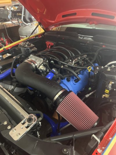

Hey everyone, I installed a 2007 motor into my 2005 Mustang. I’m at a point where I want to start the car if only to move it into and out of the garage. I tried to start it and while it turns over, it doesn’t start. Doing a little research suggest I may have to do some pinout changes or even use the 05 injectors, alternator, possibly some sensors. Honestly, it’s a bit over my head. I am using the 05 ECU and already installed a tune as the 07 motor has Detroit rocker cams and headers. The the 07 motor also came with a transmission. (Automatic)

I’m the one who gave that advice. The pin outs at the fuse box connector and how the pcm gets power is different. He tried to use the 07 engine harness

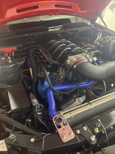

No. I bought a car with a bad automatic transmission to build into something nice. I bought a 2007 Mustang GT motor and automatic transmission to replace both in my 2005. I use the 2007 motor transmission and engine harness… Therein lies the problem.

05 Harness is off the old engine. I’ll clean it up tomorrow morning and get it ready to install. Still need to remove the 07 harness. Thanks everyone for your input, including Matt James.

Ive got my harness off the 05 engine and cleaned up and ready to install on the 07 motor which is in the car. I’ve got an auto trans and there are several plugins on it. I can’t get to most of them so I’m hoping I can drop the trans crossmember enough to gain enough access. If not I’ll have unbolt the damn k member and drop it all several inches. I swear my use of the f word has gone up exponentially since I started this project.
