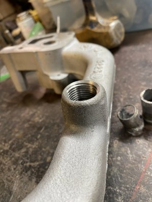

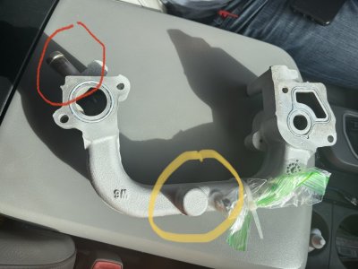

What's the benefit of the new style coolant cross over?
It has an integral thermostat housing and you only require two radiator hoses instead of the six that come on the 05-06 with its remote thermostat housing. As a result, a lot of clutter is removed from the front of the engine bay. You could instead use that real estate to mount a turbo. :D

yea i have everything to make it a newer crossover due to the 09 parts,
i do not want to pull a plug incase it breaks,, i have 15 days to throw her in and start her top make sure all is good, the last thing i need is to be pulling a head or sitting over my car for 6 hours with an extractor tool hoping for the best.. im already pushing time waiting for the clutch to come..
but it is no doubt an 05\06 due to the intake cmcv being 2 piece , the coolant crossover being the old 2way style, but for 91k on the block,it looks hopeful
