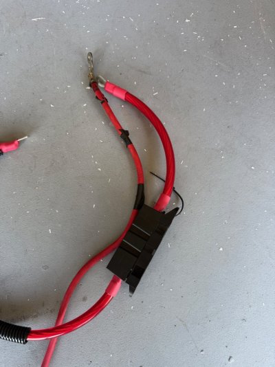

The new cable was delivered today, but they sent me the wrong one. It's the shorty version and only 30 inches long.
They are expediting me the correct one.
This cable is great quality though, very beefy and a huge upgrade.

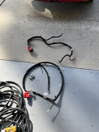

I finally got the wire replaced.
When I was searching for the original replacement, many sites showed they were no longer being made so I opted for the upgraded cable from PA Performance.
Then new one is much beefier and I'm very happy with it.
This photo is the old and new cables side by side.

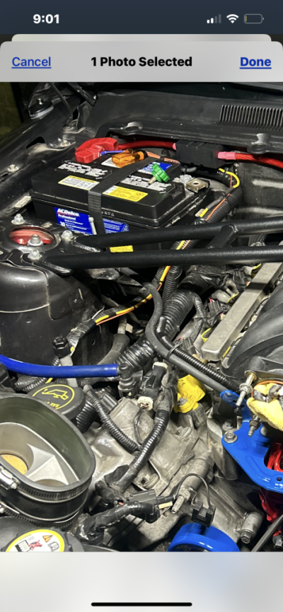

Nice! While you’re in there maybe do a ground upgrade cable from one of the non used threaded alternator case holes on the back to the strut tower in front of the battery. I’d recommend a 4gauge cable only need like 2-3 feet of it
I’ve attached a photo so you can see where I snaked the ground cable that comes out the front left of the alternator to the strut tower. The goal is to have it as short as possible to the frame and close to the battery
