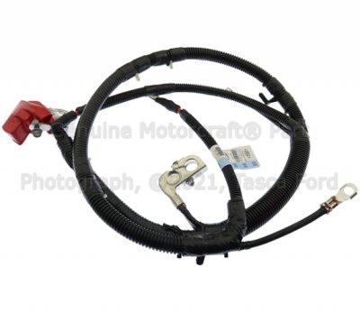

Anyone replace a the positive side battery cable? 05 GT
ZwookY
Aug 13, 2021
56
16
Positive terminal is completely corroded and "sliding" tightening bolt is broken.
Ordered the assembly but was hoping to see a Youtube video or guide some where but can't find any.

Being very careful, slice the tape off the old wire, take pictures of all the places it bolts to. Remove old wire, bolt it back (look at pictures), wrap it with new tape all done.

I have a spare laying in my trunk right now... i will grab it out and see if i can do a brake down by connector for you.... I'll send it by PM....

Tried to PM you but the system will not let me.

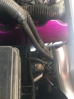

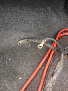

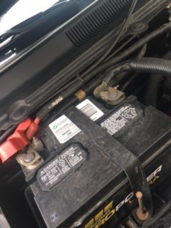

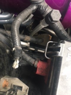

You are going to have the 2 connections at the battery (disconnect first). Then disconnect the lead to the alternator from the positive cable. From there you will have a ground at the passenger shock tower to disconnect, followed by the connection to the under hood fuse box. After you have that loose your next 2 connections will be the ground to the block (you will need to get under the car to get at it), then the connection at the starter. Be careful on that one as it could have corrosion on it and end up snapping off that stud that the cable attaches to if not careful.
Once you have the old cable out and the new cable installed connect your alternator lead to the positive cable end. Then connect the battery terminals.
Pictures I attached show the new cable ford shows then my first picture shows the connection at the battery and the alternator lead coming off of it. Then the ground at the strut tower. The connection at the under hood fuse box, where you also see the cable turning down to go to the block ground and back to the starter... The last picture shows a picture of those ends on the battery cable that I have. 73cb17dc2ad288e0ae8b9c5be7df6cfd.jpg thumbnail_image4.jpg thumbnail_image3.jpg thumbnail_image2.jpg thumbnail_image5.jpg

Thanks!!! Exactly what I was wanting to hear!!!

As Joe says get the OEM replacement unit. When I replaced mine the worst terminal to get off was the one underneath the engine support (ground)...Also, worth it to take extra time to clean all of the mounting points/terminals thoroughly. Since your old cables are about 18+ years now you may see higher voltage output from the alternator due to the new cables. I did.

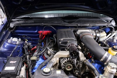

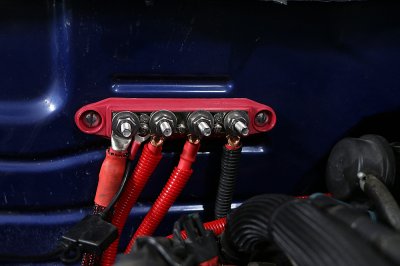

I replaced the positive cable and moved my battery to the trunk, lol! It was one of the most satisfying mods i've done to the car and now i know how to make my own battery cables. Like someone else said don't use those screw down cable connectors. those are junk. you need a crimp on connector and a crimping tool. I bought the cheap hammer kind from amazon. Works great with a 5lb sledge. you basically fuse the copper together through brute force. So statisfying! I cut the stock alternator cable and cable going to the fuse box and added new copper lugs to both. i completely removed the starter cable and ran a 1awg cable to the starter from my distribution block on the firewall. That way i have 1awg from the battery all the way to the starter. relo5.jpg

My firewall distribution block? They sell them on amazon for pretty cheap. it also has a cover that goes over it so you don't accidentally touch it with a wrench. There's a lot of different ways to do this. I will make a separate post outlining what i did and what i used. I'm thinking about moving the stock coolant overflow tank to where the battery was at.relo1.jpg
