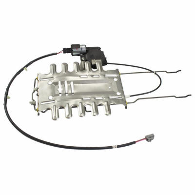

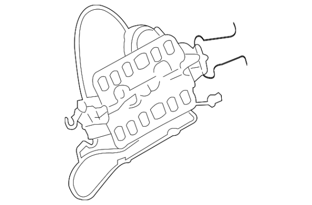

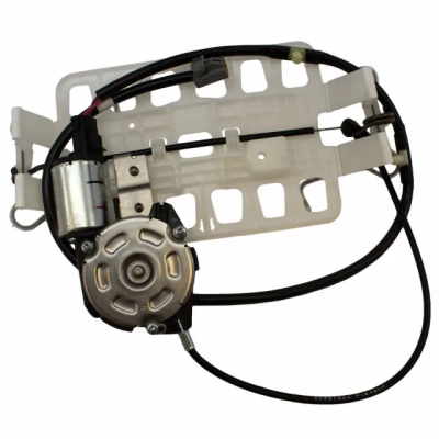

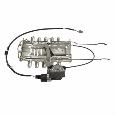

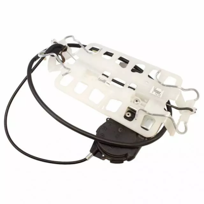

I see a couple results where 6R3Z-6365500-B supersedes "ar3z6365500a" which matches "6R3Z-6365500-A" with an extra "A" at the beginning. Tasca also lists the 2006 GT as one of the fittments for 6R3Z-6365500-B
Here're the pictures of the difference between the two. Besides the motors being moutned differently, spring bars coming off of "A" don't seem to be the same as on "B".
"A"
vs "B"
"B" with it looks like spring clips that fold out to hook into the seat frame?
