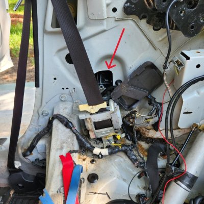

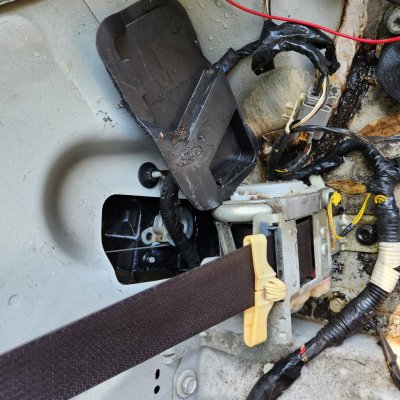

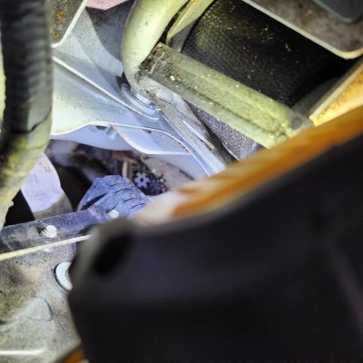

There are two drains per side for the water that runs between the top and the body. The first is up high in the corner and not usually a problem, it runs into a conventional tube that exits at the rear quarter panel:
The one that is usually the culprit is in the cavity below the rear window. Dirt, leaves, and debris collect there over the years and reduce the ability to drain. The cavity fills up, overflows under the rear seat, and eventually to the floor.
That drain empties to the rocker area weep holes, so you can't clear it from underneath.
This is how I cleared mine out:
1. Remove the seat bottom and trim panels under the window.
2. Remove the hydraulic cylinder for the top and set it aside.
3. Remove the plastic cover above the seat belt mechanism so you can get to the cavity.
4. Clear the cavity: I used a combination of air, water, and shop vac until it was clean and water ran clear and free.
The drain hole has a guard over it and the bottom of the cavity has foam sprayed in it. Once most of the crud was out, I kept blasting it with water to stir up the muck, sucked it up with the shop vac, and repeated that until the water was clear and drained freely. No more water when it rains!
