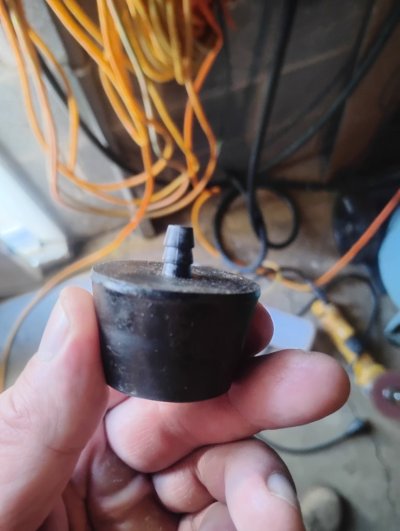

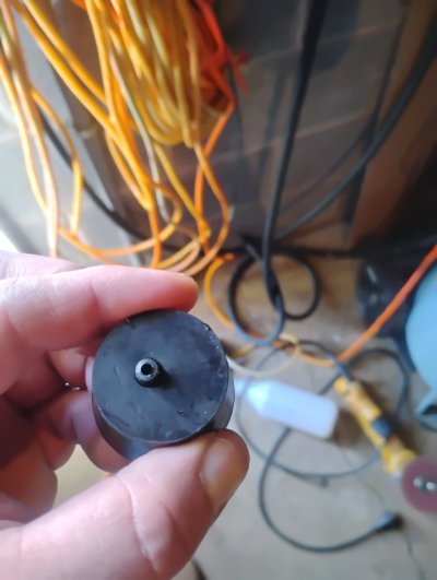

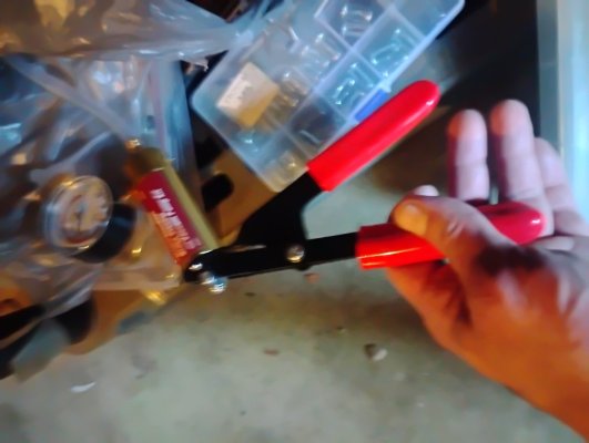

i bought a hand held vac pump @ harbor fright , .\
then went to lowes and got a 1 9/16th tapered to 1 5/16 inch rubber plug stop.,.
drilled a hole to insert and glue a fitting to attach to the pump,
then you remover the brake fluid res cap, plug it with your rubber stop ,,
and start squeezing the trigger and you should pull vac
