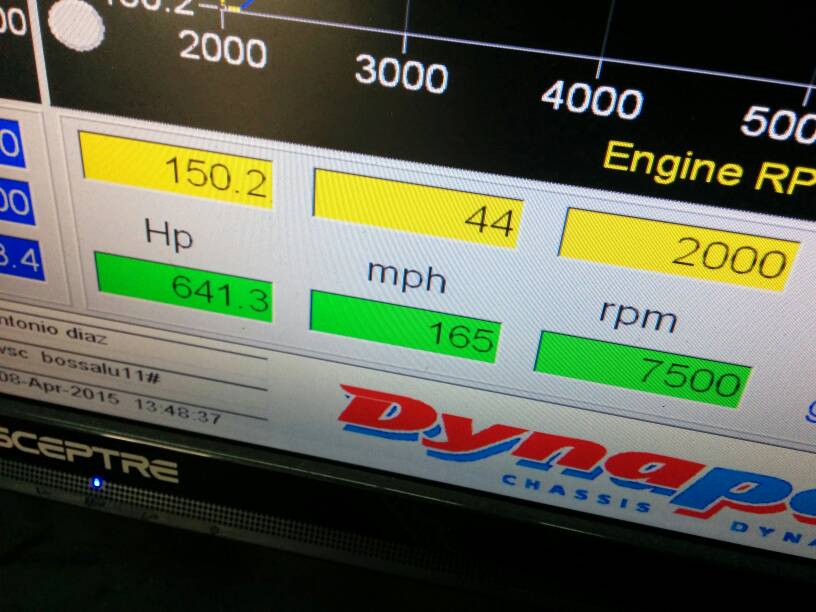

Third stage coming up tomorrow, SC aluminator, boss 302 heads, FRPP exhaust cams, CJ TB, JLT CF CAI and more boost!

New numbers
wow.
I was behind a newer black 5.0 with a license plate holder that read 650HP yesterday.
I was just thinking yaaaa right buddy its probably stock or something..
then I though hmmmm..
those tires too look quite a bit wider than mine..
I guess he saw me chuckle at first in his rear view or something because when the light turned green he took off so hard that every driver of every car within earshot literally stopped in amazement and watched as he went through 1-4 and then got on the highway. Never seen so many jaws drop at once. Traffic completely stop as people watched it was that good.
All I can say is that I was speechless.
Then I come to this thread and see your dyno numbers and I cant help but think how much fun you must be having.
