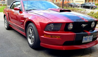

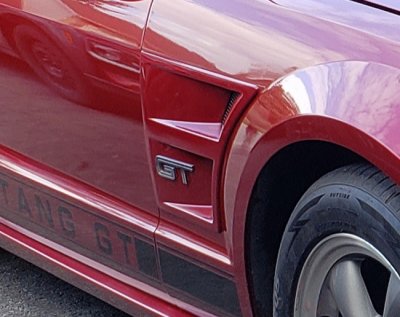

Hi FrankieD,
I have a functional hood scoop for cool air intake as well as piped side scoops for hot air dissipation. This setup works very well for keeping my baby cooler.

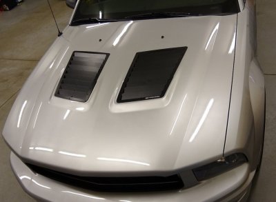

I replaced my hood with a GT500 hood with functional heat-extractor. It’s way better at removing heat than the stock GT hood I had, that also had functional heat extractors.
If you are just going to modify your hood anyway, I would pattern it after the GT500 hood, and place it similarly too. It needs to be in a low pressure area to be fully effective.

I'm looking for a hood that extracts heat and really dig the hood you have! Can you let me know what brand or the name of it?
It's a stock 07-09 GT500 hood with trackspec louvers.
