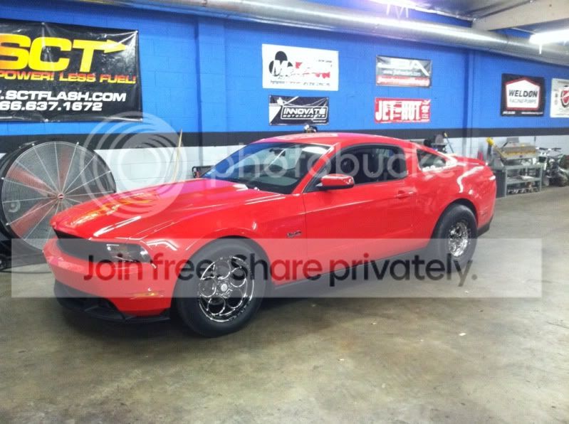

Took our shop car out to Famoso raceway in bakersfield california for a private rental, we ended up making our best pass to date towards the endo of the day after some suspension adjustaments and shift point chages. Drag times shows 1807ft of DA at the time of the run. Previously we had taken the car to our local 1/8 mile track irwindale raceway in stock trim (8.80@84 ), and then with a cold air, tune, exhaust and 18" drag radials(8.09@87). We have had plans with this car since the beginning and already have a Procharger F1C, boss heads, new 5.0 block, and new stock crank on the shelf waiting to be assembled. But for now we are having some fun with the stock motor in n/a trim. The car is a base model 2012 GT auto and has pretty much the most popular bolts on we have been installing on our customer cars.
Engine parts list:
JLT Cold air
Ford racing 90mm TB
Ford racing Boss intake manifold
BBK long tubes with catted h-pipe
Magnaflow 3" exhaust
Muscle Motors Tune
Circle D 3800 stall converter
Suspension parts list
Axle exchange aluminum driveshaft
ford racing 3.73 gears
Eaton true trac differential
Strange single adjustable front struts
Strange dual adjustable rear shocks
Ford racing cobra jet spring kit
Team Z lower control arms
Team Z adjustable upper control arm and mount
Team Z adjustable panhard bar
Team Z anti-roll bar
Strange Cobra jet front brakes
Ford racing shelby upper strut mounts
Weld 17" one piece magnum pro wheels with M&H 28x4.5x17
Weld 15" single beadlock magnum pro wheels with 275/60-15 hossier drag radials
We have big plans with this car and will be installing a set of comp cams in it within the next couple weeks. Then will come the procharger F1c with the stock motor to see how fast we can go with the stock longblock.
