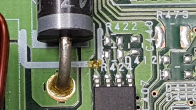

Now I had the radio on the bench and decided to take the top of the housing off. No surprises. 6 Screws and it popped off fairly easily. One of the forums I was into mentioned something about bad solder connections or excess flux left over from the manufacturing process that can cause issues over time. After looking inside with a magnifying lamp, I found what looked to be at least one issue. You can see in one of the pictures what I mean just to the right of the round part, that doesn’t look right. My brother happens to be a mechanic and very good with soldering said he would try touching it and any other areas with a soldering iron. While I had to wait a couple of days to have him do that, I continued to see if I could fix it myself. I sprayed electrical contact cleaner all over the board and used a Q-Tip to gently clean anything that might be the culprit and still no improvement.

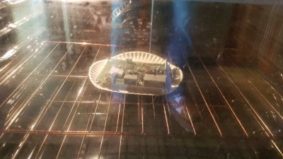

Back on the internet I go and ended up going through pages and pages of links and I was finally offered a solution on an F-150 forum. Two posters said that they took the motherboard completely out of the housing and baked it in the oven!!!!! I couldn’t believe it. I mentioned this to my brother and he said that people have to do it with GM instrument cluster circuitry all the time so it sounded possible to him. I figured what the heck if it’s cooked then I’m going to cook it literally as one person said they used 385°F and one said 350°F. It went into the oven at 385°F for 10 minutes(The other Picture). I didn’t wait overnight like the posters did but let it sit for about 3 hours until it was completely cool for me. I put everything back together and it frigging worked!!! I never thought in a million years that it would but it did. Drove around all day and no problems. The theory is that the heat will soften the solder and it will bleed back together.

4) Using a non-coated paper plate and four small crushed up balls of aluminum foil, set the circuit board on top of the balls placed at each corner, being careful to keep clear and any of the circuitry. This allows heat to get under the board. And put it on the paper plate. The other posters mentioned that they also placed foil over the plastic connectors to protect them from the heat but “Ain’t nobody got time for that” so I went commando as you can see. But whatever floats your boat.
5) Preheat the oven to 385°F or 350°F (I used 385) and bake for 10 minutes until golden brown!!! The plate never burned but it did get golden brown so be careful. Also there were some fumes that came from the oven so the fans all went on and windows opened.
6) After it’s finished, turn off the heat and let it cool completely before you touch it. DO NOT TOUCH THE CIRCUIT BOARD UNTIL IT IS COMPLETELY COOL. The solder will be hot and any sudden movement may cause components to fall over or fall off which, of course, will completely ensure your radio is ruined.
Anyway I did this and it worked. Be careful throughout the entire process. You don’t want to damage the interior of your car or cause a fire from the shake and bake. I realize this is long but I just thought people might like to know about this if it helps. Your radio is more than likely useless before you try this anyway so it won’t hurt if it’s your last resort like it was for me. I don’t know if this will last or not but it saved me some money and if the radio acts up again I’ll be doing the same treatment. Good Luck!
