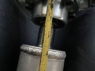

That looks like the one. Give them an email to make sure Saleen didn’t do anything special. Then check LMR, CJ Pony and even eBay for cheaper prices. My old DS was definitely worn. The replacement has made a big difference in ride quality. I did have to loosen LCAs to install. After install you need to check space at rear CV joint. 3.25” to 3.75” is acceptable range.
